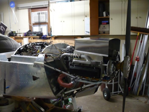

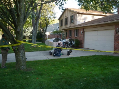

Brief Description:  First engine run on FuselageFirst run in driveway
The carb is a MA3SP from a 65hp Continental
Warp drive two blade prop set 8.5+ degrees? Roy has it now and can validate angle.
Ambient temp? 45 50 61 Baro 30.08
Check timing. 32 degrees? Yes on a side 29 on b side
Oil pressure 30 psi cool start 1150rpm
38 psi @ 1800 rpm after 1hr run
Fuel press 3 to 4 psi on A and B side as high as 5 under load. The needle is warvering (is that normal?)
cht 200 -250 b side (probes were in the end of the heads not the bottom like they should have been)
Egt 1100 b side and a side (Not leaned out)

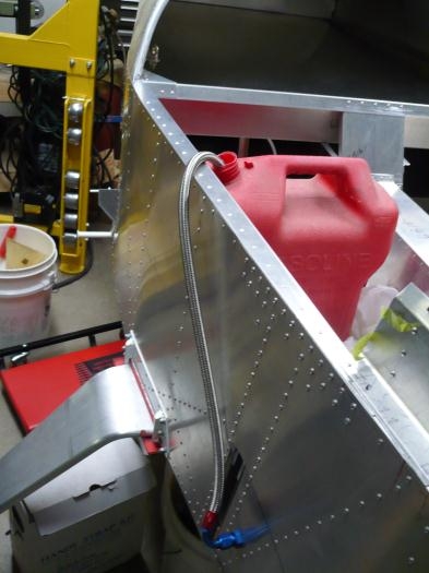

Fuel delivery
Fuel delivery
