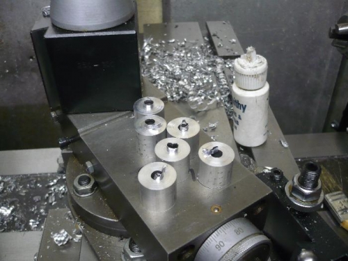

Finish making spacers.
Get .25" hole centers marked by assembling with spacers and transfer punching. Drill on drill press and reamed at assembly.
