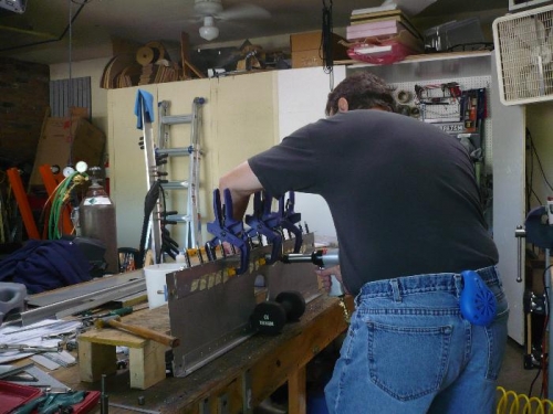

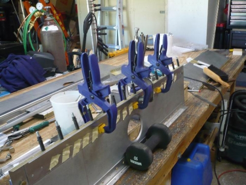

Proped it up and used the same bucking block. 6 trigger pulls give the right set.

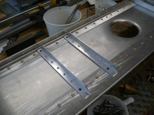

Reamed .25" holes first, just one end of the angles. Put bolt in and transfer punched the center of the other end while keeping it square.
With the two bolts in the ends of all the angles is was easy to layout the 5 hole A5 pattern and pilot drill through the angle and the web.
Held shims in place and drilled end and clecoed. Held other end and clecoed. Finish pilot drilling all the shims. Open holes up for A5 rivets.
Disassemble and deburr, reassemble and rivet the A5's.
