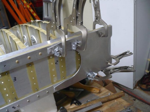

Wing root doubler

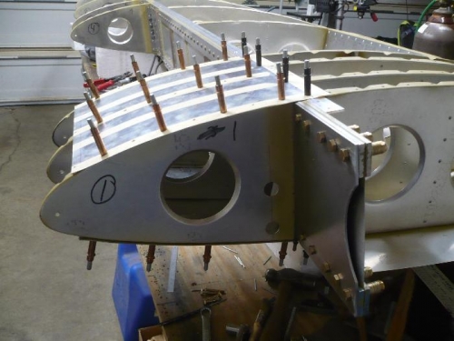

Turned wing around to finish up the LE work

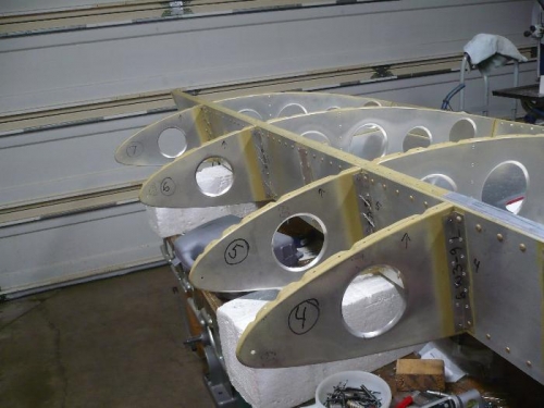

Riveted nose ribs 4 - 7 back in place.
Clamped and transferd hole centers to .125" wing root doubler. Drilled and reamed all holes. Bolted and torqued all but the rib and L-Angle bolts.
