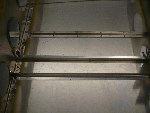

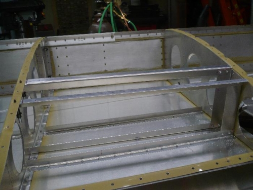

Frame box for aileron bellcrank support
Cut L-Angles, joggled one end. Pilot drilled end holes thru skin.

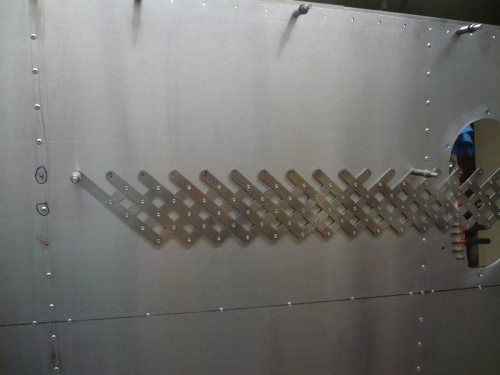

Rivet fan for 40mm spacing off end holes on the skin.
Drilled and clecoed, deburred and riveted bottom frame.
Top frame is riveted to support and clecoed to rib. Need to pisition top skin and mark / drill end holes.
