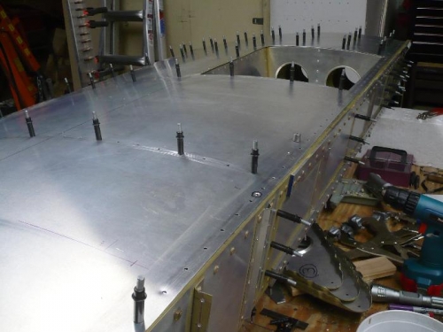

Brief Description:  Transfer holes from top skin to new spar cap

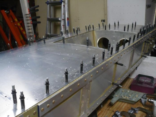

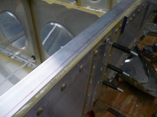

Marked tangent ling of the extrusion on the top of the new spar cap. Leveled the wing and set the top skin in place. Using a fine point sharpie of a different color marked all the holes on the spar cap. Removed some clecoes to see and measure the distance, well within tolerance.
Used transfer button to mark the centers of the holes with a pilot drill. Pilot drilled all holes. Silver cleco every other hole. Open holes to #30 then to #21. Black cleco every other hole, remove silver clecoes and open those holes to #30 then to #21.
