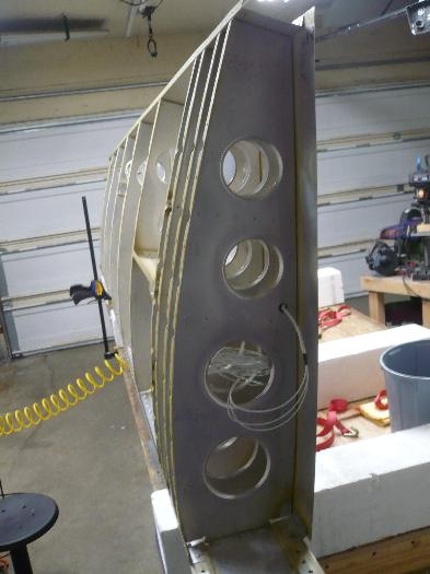

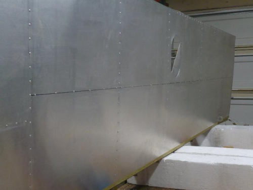

Brief Description:  Stored top skin, removed rivets, L-angle Bottom

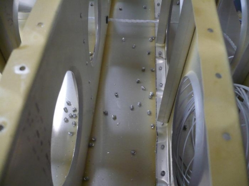

Removed the stuck rivets with automatic center punch and steel backing block. Some of the rivets had to be removed with end cutters and diagonal cutters.
Transfered hole patterns from skin to L-Angles, pilot drilled, finial drilled, and riveted.
