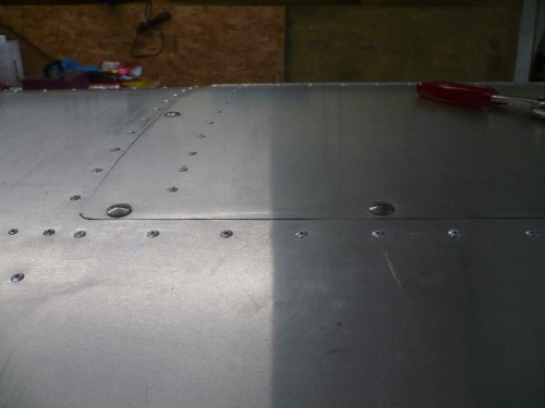

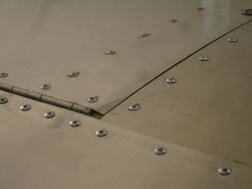

Used flanging pliers to bend the edges down a little bit around the wing locker door, that took care of the gaps I was seeing.

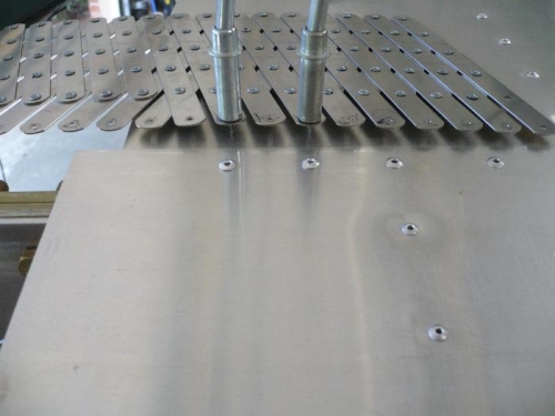

For the 20mm rivet spacing on the spar caps I just used the rivet fan and silver clecoes. Insert the clecos in the fan, insert the tips of the clecoes in the rivet heads, drill between.
Winf locker door
Winf locker door
Put hole in the middle
