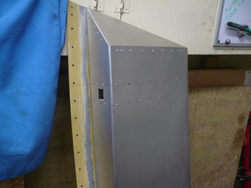

Fit everything then removed the aileron balance arm to rivet.
Placed the balance arm back in and torqued the bolts.
Placed the other two joint reinforcement plates, drilled, deburred and riveted aileron closed.
It still has the 13mm washout / twist.
Trim motor reinforcement

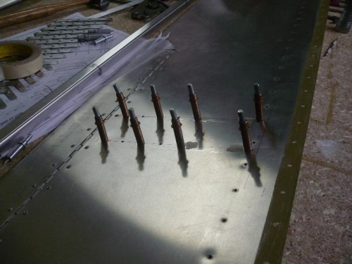

Rivet without arm in

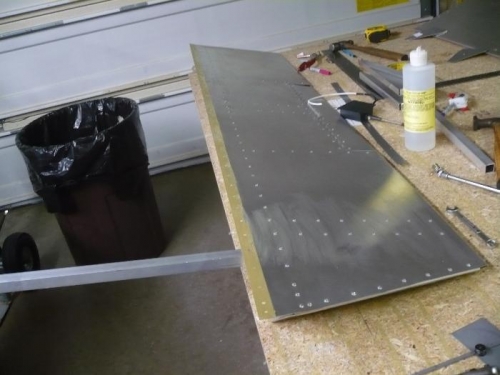

Closed up and ready to fit to wing
