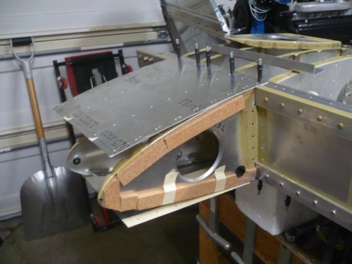

Setup other table and brought in LE skin to make templates to hold the 3 nose ribs in place.

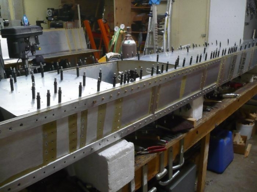

Placed top wing skin and drilled rivet holes in the new spar.

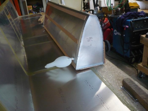

Sealed fuel tank and tested for leaks, found one at the ground wire screw on the float, tightend screw and the leak is gone, glove stays inflated.
Set templates in place, ready to cut nose ribs to fit new setup.
