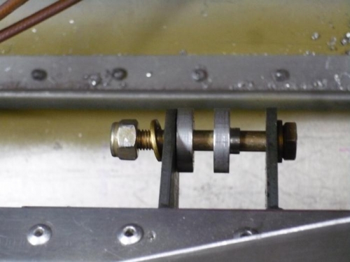

Brief Description:  Bundled some wires and made flap mtr bushings
The new style flap motor uses 1/4" bolt and has smaller mount surface. Made step bushings to pilot on the 5/16" ID of the brackets and take up the extra space .1975" on each side.
Still need to make some clearance on the bracket to line up the hole in the motor.
