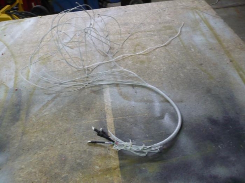

Brief Description:  Make up loom for the Nav/Pos/Land/Taxi lights

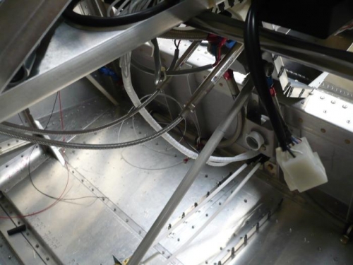

Using two different sizes of spiral wrap to contain and protect the wires. They route through the Center Spar with the Brake Lines and follow the same path and share the same grommets out to the wing roots.
Have extra wire at switch end

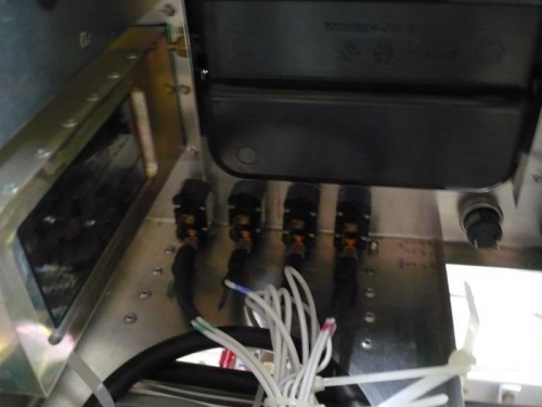

Switches
Switches
Center IP route
Center IP route
