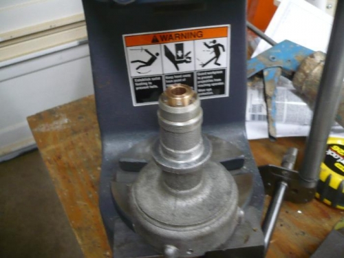

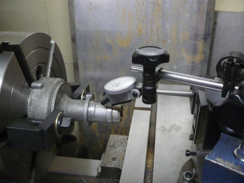

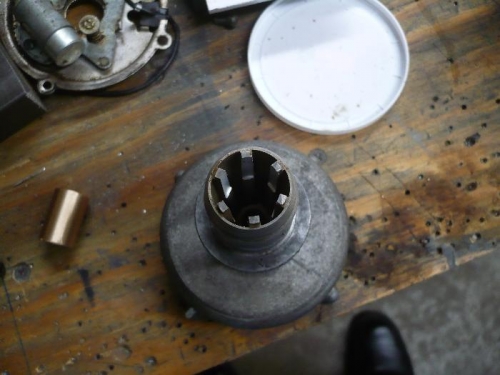

Bore lower base for bushing
Bored out the bottom of the distributor base to accept the bushing with a .002 press fit.
Pressed bushing in with support on the bushing below not just the rim of the distributo body.
Check tram
Bored to -.002
Bushing pressed in
