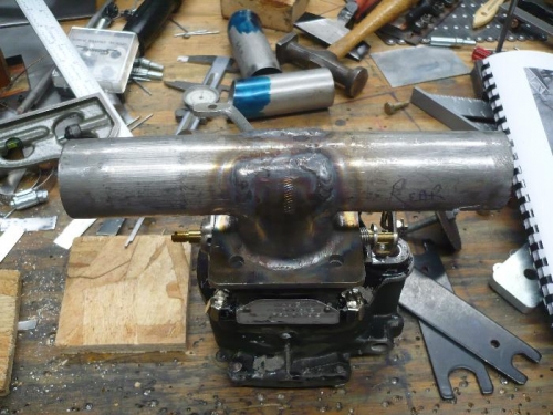

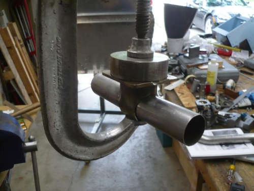

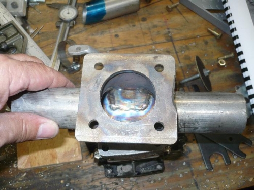

Intake Fabrication
Tack it where it touches, make other area touch and tack them. Joint welds. The argon purging really makes the inside smooth.
