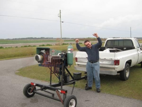

Getting engine running at CC17
Ran engine for 20 minutes at about 1800-2000 rpm to warm up the oil.
Changed the oil and filter and ran it again fo another 20 minutes. Checked filter ( cut it open and spread it out) and oil and everthing looked good.
Mark P and Me
It's Alive
