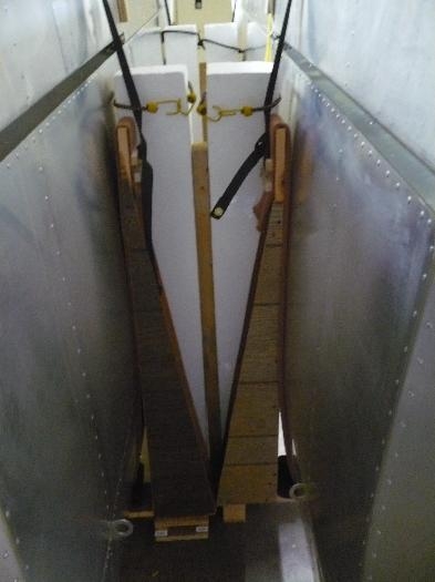

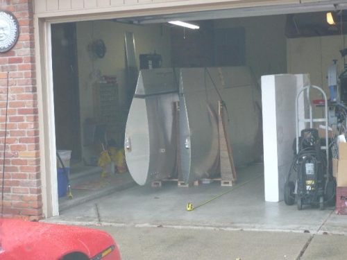

Renting 17' U-Haul truck to haul the wings. Box floor to get support figured out before truck get here.

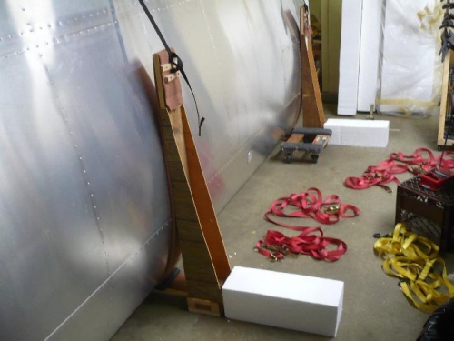

Two 6" syrofoam blocks and one 2 x 4 spaces the wings apart so the cradles are just touching at the base. The total base width is 48".
That leaves 39" to fill at the base to keep the base still from lateral movement. So 19.5" will fill the void on each side of the base to the outside wall of the truck.
