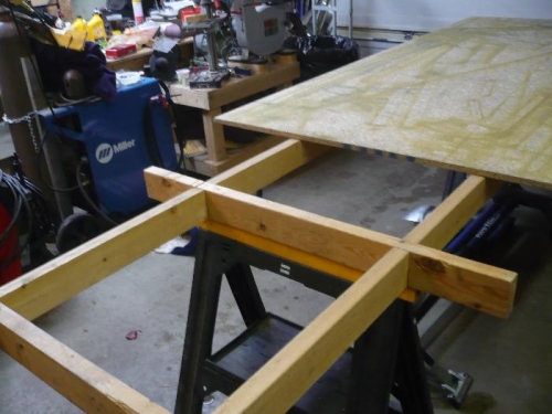

Make table to do the upgrade on
Using my cutting table because its portable and should be strong enough once it is screwed together.

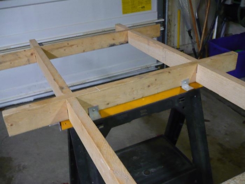

Located Aluminum angles to prevent sliding on the horses. Placed them on each side of the horse cross brace and each end.
Once the top is in place I will screw the top to the frame and that will keep it from moving around to much.
12' long interlocked 2x4's

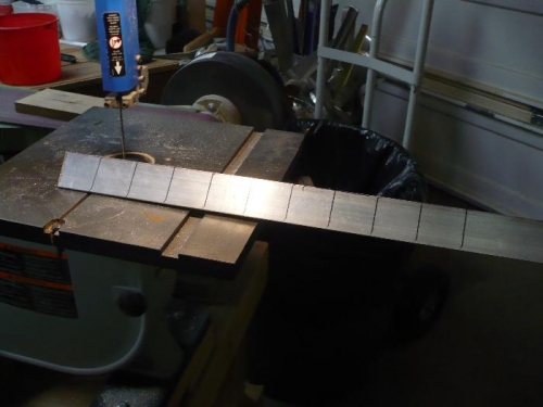

Cut angles & drill hole
Angles on both sides & ends
