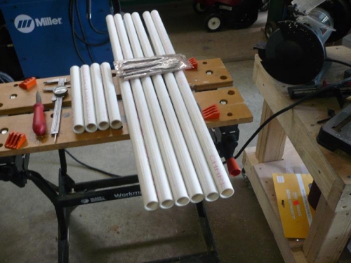

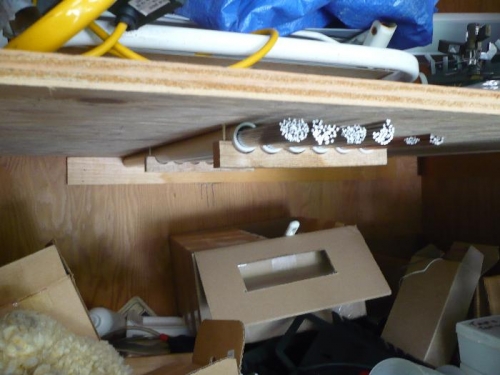

Make Rack to hold welding wire
The wire is in bags from the welding supply but needs to have a place that makes getting at it easier.
Got two 8' lengths of 3/4" ID PVC from Home Depot and cut it to six 32" lengths.

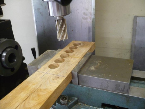

Cut six 1" dia holes on 1.05 centers in a piece of 3/4" hardwood.
Split the on bandsaw and drilled holes for screws to hold the pieces up around the tubes.
