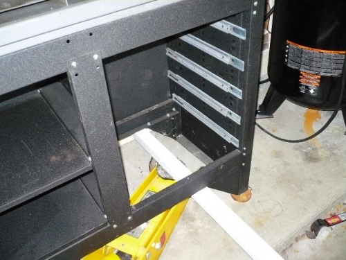

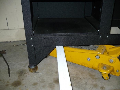

Final leveling of the Smithy Granite 1324
This morning placed the pucks under the feet and adjusted the screw legs. Used floor jack with a 2" x 2" x 4' steel tube to lift the ends and get the final leveling done.
Floor jack to lift
Mark floor to see if it moves
