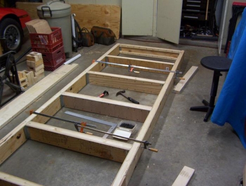

Building Table
I cut one leg the final height and positioned it at the far right in this picture. Then I used a line level from that height and marked all the other legs. Each leg ahs a unique numbered position to compensate for the floor slope.
Imagine the legs sticking up
