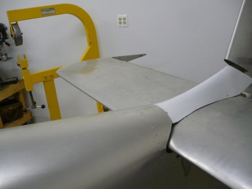

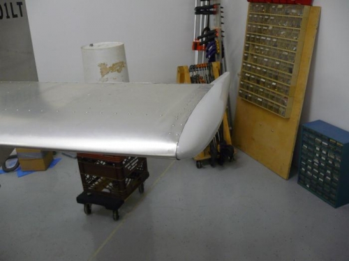

Brief Description:  Rivet horzontal stabilizer tips
Marked and riveted the tips.

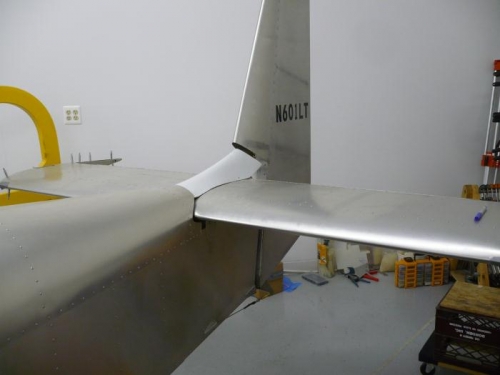

Re-tensioned the rudder and elevator. Trick for setting the rudder, line of sight from the rear of the rudder left and right side, count the rivets on the fuselage hoop 6B21-2, make them the same (right and left), when adjusting the rudder placement.
