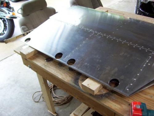

Cutout Elevator for Trim Tab
After so painstakingly fabricating the skin of the elevator it was a little difficult to cut into it. Rough cut out first with hole saw, then snips, leaving about 1/4 to 1/8 inch for final trim to line.
Holes first

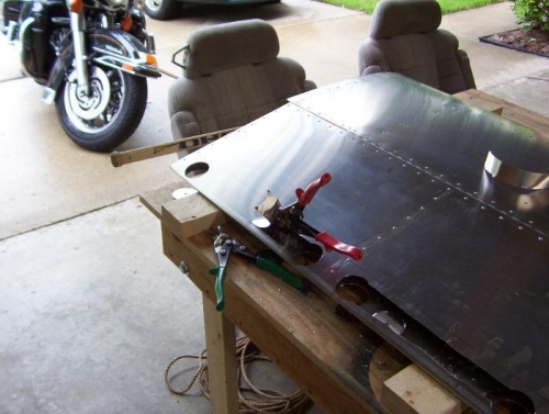

Rough trim with snips

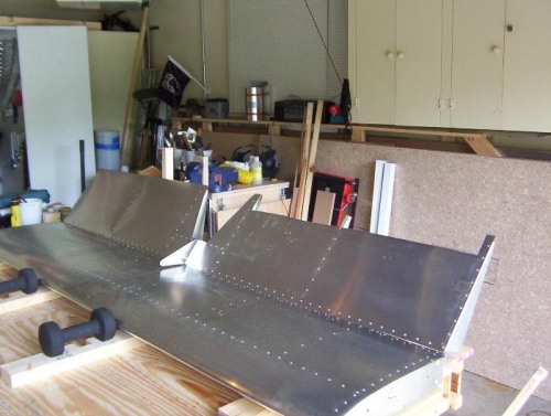

ready for final gring to line
