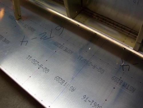

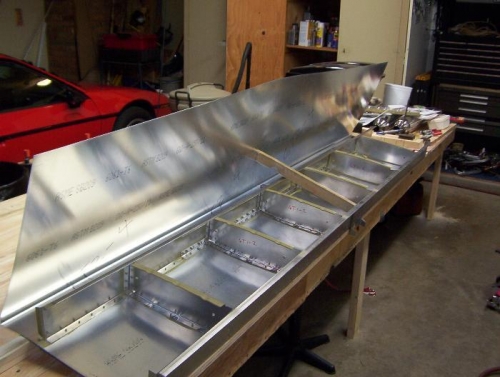

Layout first hole on ribs and begin transfering that information to the top skin surface. Rivet lines established on top skin then rivet spacing.
Extend Rib rivet lines to rear spar

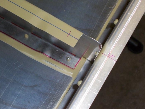

Mark first hole & transfer to skin
Ready to punch & pilot drill
