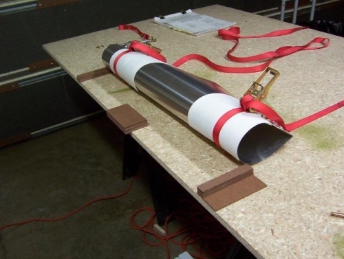

Brief Description:  Forming Rudder Nose

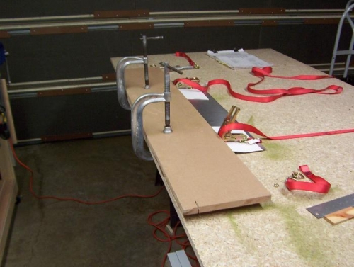

Used some tie down straps to hold the rectangle. The white stuff is several layers of paper to protect the aluminum. Once it was banded, placed 28mm shims to act as a stop and just slowly clamped the 3/4 MDF down to them with the banded material sandwiched between the table top and the MDF.
Ready to clamp
Ready to clamp
Clamp to 28mm stop block

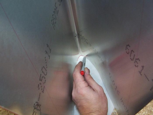

Check Radius
Check Radius
