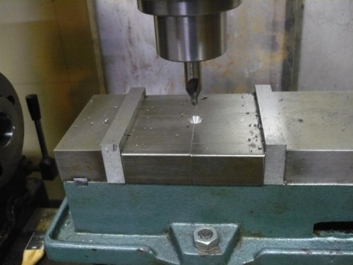

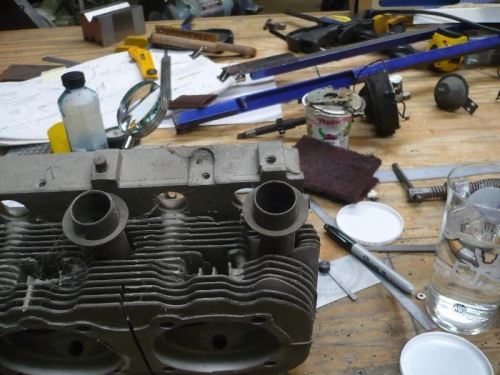

The exhaust stubs are 1.16" OD and I will need to size the tubes I make to mate to them. So I'm making swage blocks for the final size.
1" thick steel 4" x 2" two blocks. Drill out center hole.
Stubs are 1.16
Stubs are 1.16" OD .06" wall
Notice split in the center

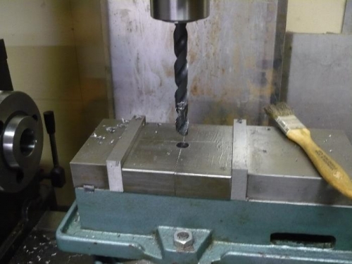

Drill 1/2 hole
Drill 1/2 hole
