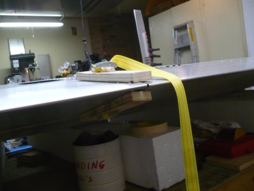

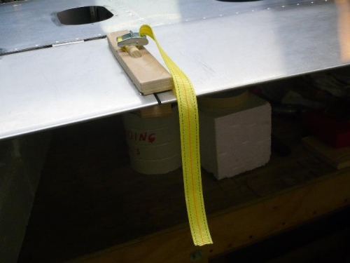

Make gust locks for wing storage

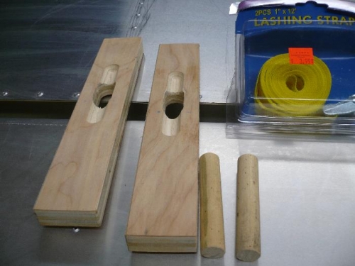

Took some wood and lashing strap from Harbor Freight and made two gust locks for $4 total.
With a .5dia ball nose end mill, carve slots in plywood to hold the dowels in place.
With a .625 end mill make a slot through .8 long on center so the strap won't lock down under the dowel.
With a little rubber on the faces it should stay in place.
As they are they will work for now and when I transport the wings to the hanagar.
Gust lock parts
