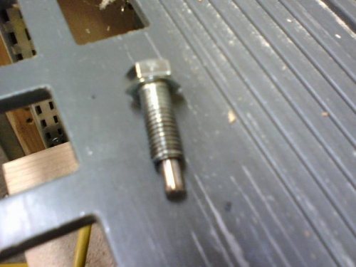

Image 1) Had to make a pin to replace the missing one. This locates the lower anvil and keeps it from twisting while working. Drilled a 15/64 hole in the bolt and pressed a 6mm dowel in.

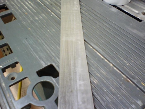

Image 2) Tested all the wheels after cleaning them up with paint thinner. Only one need a new pin, the flats on the ends are not inline with each other and the anvil won't set down in the slot.
Image 3) Tested the tracking with all the dies, I think it will work.
Pin for locating anvil

Test the tracking
Test the tracking
