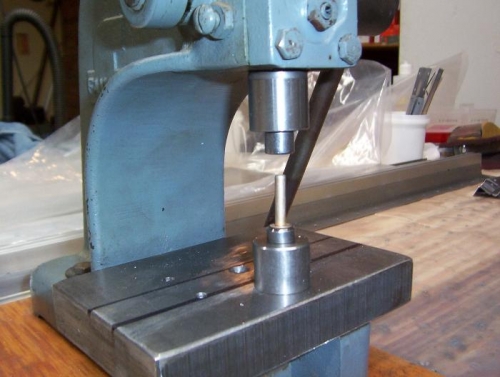

Brief Description:  Setup arbor press for Riveting
8am awoke to this view out the window, you can't see it real good but it is out first snow of the season. This is the earliest snowfall ever recorded here in the Detroit Michigan aera.
No pictures but I drilled and tapped a 1" steel base plate to hold the rivet faces in my little 1 ton arbor press. Made upper and lower adapters to hold the squeezer faces. Adjusted handle swing also for the long rivets.
