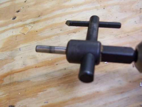

I made up a 1/4" dowel to fit my 3/16" piloted flycutter by grinding one end of a hardened dowel pin down to fit in the hole.

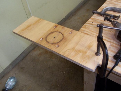

I took a piece of hardwood plywood, drilled a 1/4" hole on the drill press, and then clamped that piece to the table to act as the pilot hole. Using the dowel on the flycutter should make it last longer.

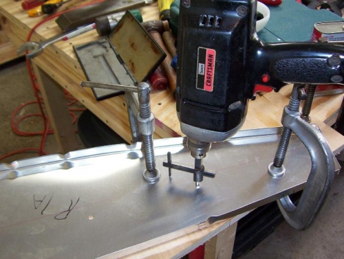

I am using a 3/8" variable speed drill. First line up the hole, then add the clamps. Cut slow to start and after marking the part add some cutting oil, I used 3 drops Tap Magic.
Flycutter with Dowel pilot
Hardwood Plywood
Hardwood Plywood
Lining up the hole to be cut.
