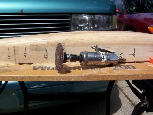

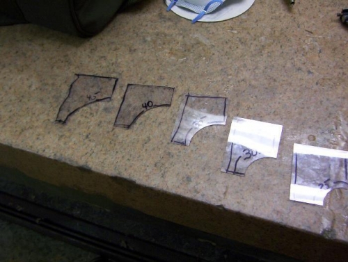

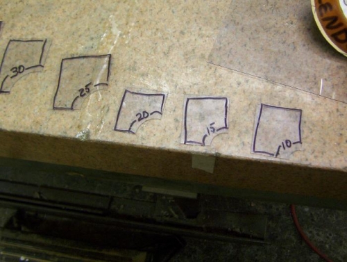

Stabilizer End Cap Tool
Made some acetate templates to give me something to follow for making the transitions. I marked the block at the locations where the paticular radi belonged and roughed it in with the 24 grit grinding tools.
acetate templates
acetate templates
24 grit 3" pad to rough in shape
