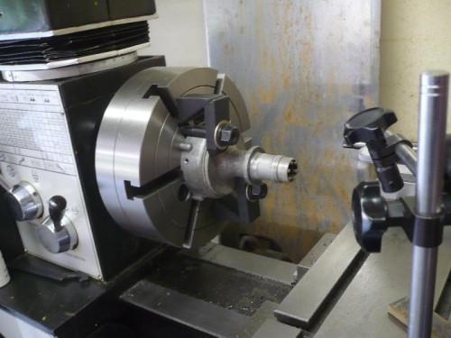

Setup fo boring distributor bushings
Checked the tram of the point plate base to the clamp down ridge, no variance (.0004). Trammed in the outer OD to within .0004. Should be able to bore and ream in this setup.
