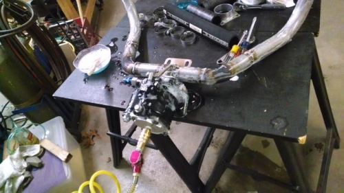

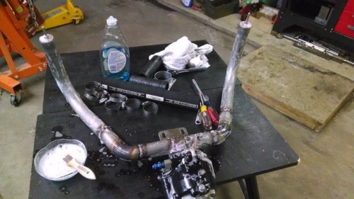

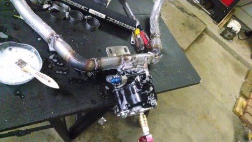

After plugging the hole and reading about flange leaks I made this setup to test the manifold with the Carburetor attached.
Applied low air pressure 2-7 psi controlled at regulator. Held finger over fuel inlet during the test. Only leaks were the slight leaks at the throttle plate as expected. Checked the entire manifold and Carburetor.
Airworthy.
Made plate for air line
Used soapy water to detect
Plugged ends of manifold
