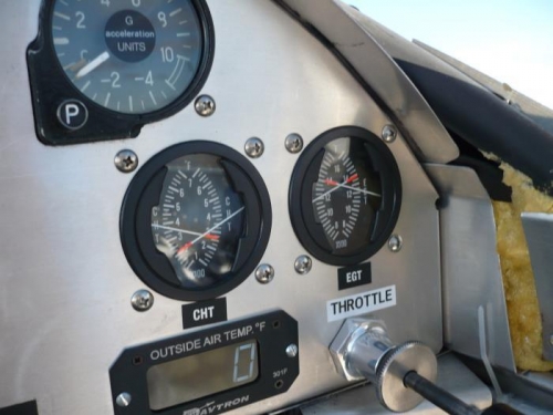

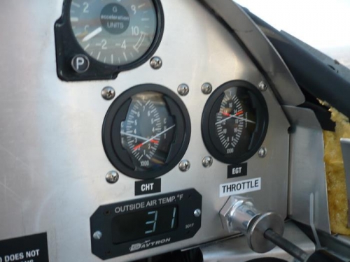

After landing with the 93 MOGAS I did a full Static Run up and got 2680 RPM and 1250 EGT. Switched tanks to 100LL and throttled it up to get it in the carb. Another Full Static showed 1400 EGT and 2700 RPM. The 66" warp drive prop is pitched at 9 degrees 45 minutes.
93 MOGAS 10% Ethanol
100LL
100LL
