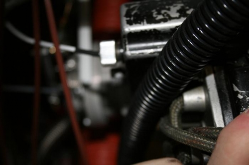

-Soldered up the right mag P-lead at the magneto and attached it.

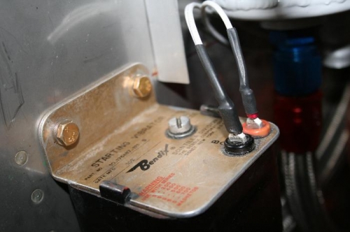

-Had to modify the leads to the vibrator to accomodate my pushbutton start button. The scheme I have from Aeroelectric elliminates this, but I want to keep it.

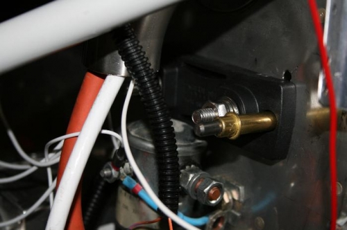

-I ran out of female PIDG terminals to wire up the switches so I moved to the ANL current limited. Did some head scratching and finally decided on where to put it and the shunt where it makes sense with the start contactor.
-Drilled the holes for the ANL holder and put it loosely in place.
Right mag P-lead on.
Re-did the 'in' wire on the vibrator to accomodate my start push-button
ANL holder just above the start contactor
