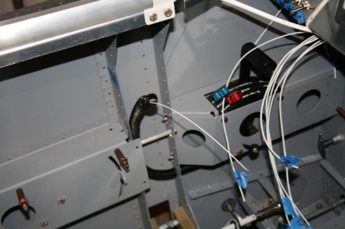

-Finished the upgrade to 14awg wire for the taxi and landing light circuits by pulling the wires from the pigtail at the wing root to the switch on the right side and then running the c/b to switch wires.
-Drilled a hole into the left gear tower just under the throttle quadrant for conduit

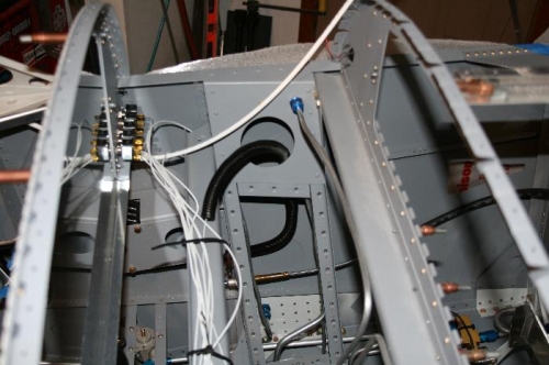

-Pulled 1/2" conduit throuh the center section web on the left side and then under the throttle quadrant and up through the left gear tower. This will handle the wires for the flood light switch and the fwd map light switch and the left console light.
-Studied how I want to route the wires for the flood light circuit and then
-Ran 22awg wire to the flood light switch from the hot batt bus

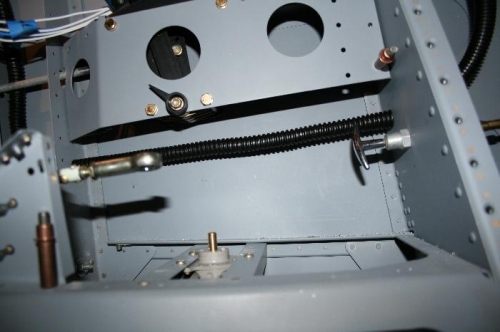

Conduit under the throttle quadrant
