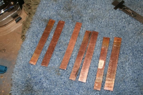

-Finished cutting and sanding the copper bars that will tie the circuit breakers (c/b) together into organized buses.

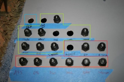

-Layed out the c/b panel. Due to changing my mind on a couple of items I need to get a few more breakers (not the holes). See pic #2. Sorry you probably can't read the labels.
As a side note, I was agonizing over my flood light circuit. I want to be able to turn ON all of the inside lights with one switch near the canopy seal on the left side and still be able to turn those lights on independently as needed - such as map lights, baggage lights, panel lights, etc. My buddy Mike helped me out and it is pretty simple in the end.
Copper bars ready for duty
C/B panel - blue is hot batt bus, green is main bus, red is e-bus and brown within red is avionics bus
