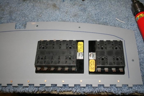

-Located and drilled the mounting screw holes for the 2 fuse buses. One will be a sub bus from the main bus and the other smaller one will be the hot battery bus.

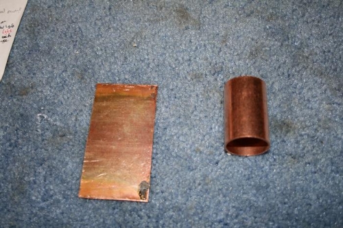

-Took a 1" copper pipe coupling and flattened it out and cut it into strips for bus material to connect circuit breakers together - learned that tip on VAF.net
The left bus is the sub-bus (extension of the main bus) and the rigth is the hot batt bus
Copper is easy to work with. I cut 4 stripes out of this piece 3
Copper is easy to work with. I cut 4 stripes out of this piece 3" long
