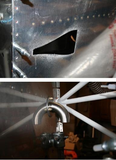

-Used firewall sealant (flamemaster) to bond in the naca scoop and also to seal the firewall wire penetration that was subsequently bolted onto the firewall
-Crimped the #2 awg lug starter wire and crimped the #4 main power lead lug.

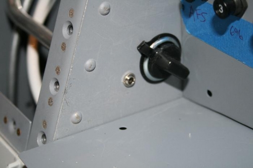

-Located the aux audio in stereo plug on the right gear tower and soldered/crimped all the connections and installed.

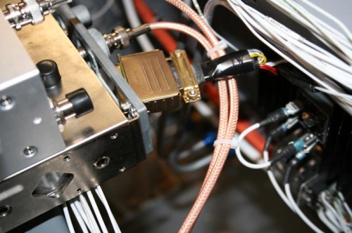

-The Garmin GTX327 xponder I got was used so they just cut the wires on the d-sub connector that ties it to everything else. Using the install manual I figured out which wires went to which pins that I needed and wired them up. I wired up the avoinic master and pwr lead together to the c/b (c/b gets pwr when the avoinic master is selected on), wired the ground to the avionics grd and connnected it.
-Wired up the ground wires for the dynon - one was main grd other was shielded wire ground. Both went to the common avioncs ground terminal. I also organized and bundled the dsab and laptop cables on the dynon harness that won't be needed for now.
Naca / Firewall penetration
Aux in plug
Aux in plug
Wired up the xponder (execpt the serial encoder input from the AFS - which I don't have yet)
