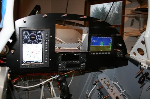

Today was a benchmark day. I powered up the DC power distribution system and a some of the avionics.
-I routed the start wire and main pwr distribution wire through the firewall pentration (see previous post) and connected them to the starter contactor. I then connected the start contactor lead from the start button to the contactor.
-I then rechecked all the loose wires that needed to be bundled and secured so there was no chance of a short. Those wires were (regulator, AFS, 300XL, and 696) since I don't have those components or harnesses yet.
-I also tripped all the c/b
-I then hooked up the battery - no smoke
-I then turned on my hot batt bus powered flood lights - worked, no smoke
-I then turned on the batt switch - batt contactor clicked, no smoke
-Put in the breakers for the avoincs and avioncs bus and e-bus and starter contactor

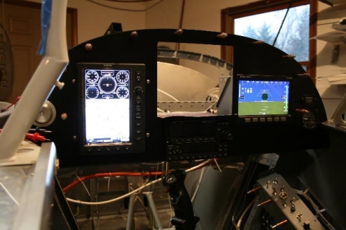

-Turned on avoinics bus and Dynon fired right up - no smoke
-Turned off the batter master switch and activated the ebus alternate feed and that system worked as advertised.
-696 was turned on via batt as I'm waiting for the power wire from Stein along with my AFS3500EE and the harness for the GNC 300XL.

Dynon is running on ships power
