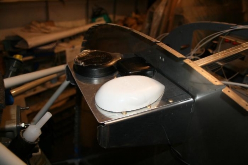

-Finished up the GPS shelf this morning by mounting the antenna to it and cleco'ing it to the firewall so I can figure out wire runs

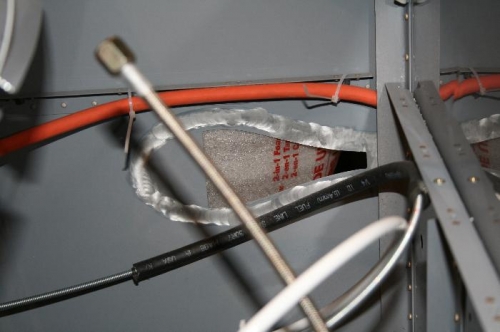

-Made a pattern for the contact surface of the fuselage fresh air naca scoop so I could use it to remove primer for the bonding area when it gets prosealed to the skin
-Marked off the contact surface and used a wire wheel on the dremel to scuff the skin

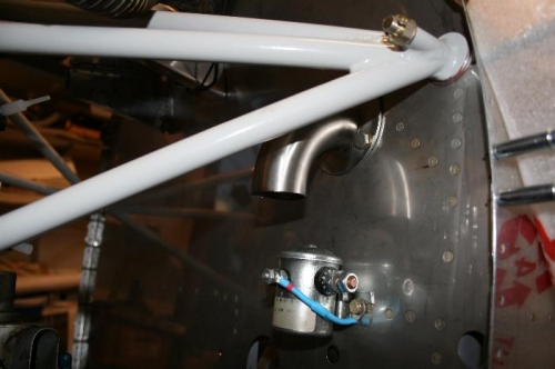

-Then I started on the firewall pentration for the 'big' wires (starter and main bus)
-Had to cut the shower rail end off for my firewall exit.
-Located it on the firewall and drilled the pilot hole. I ended up using the HF 1 1/4" hole punch I then installed a grommet that fit inside the 1 1/2 ID of the stainless elbow.
-Then I located the three attachment holes and drilled same.
I'm trying to prep the pentration and naca at the same time so I can mix up the proseal and seal them both at the same time. I'll also fire sleeve the wires at the firewall exit.
Satellite antenna shelf
Naca prep for proseal
Firewall penetration
