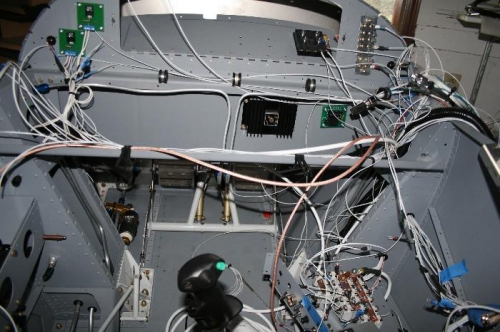

Brief Description:  Infinity stick grip terminal + wire bundle managem
My Infinity stick grip wires directly to a terminal strip (actually 2 strips) inside the c/b panel. I set about getting the outgoing wires from the terminal made with labels and ring connectors on the terminal end.
I then moved my attention to the rats nest coming out of my right gear tower. To that end I drilled holes for 5 adel (-12) clamps that will support the wire bundle running along the back of the fwd baggage compartment. I then drilled holes for the same for the z cross brace that runs under the instrument panel.
Infinity stick grip outgoing terminal wires done - just need to be installed
The wires have taken over!!! Hopefully after tomorrow it will look alittle more organized.
