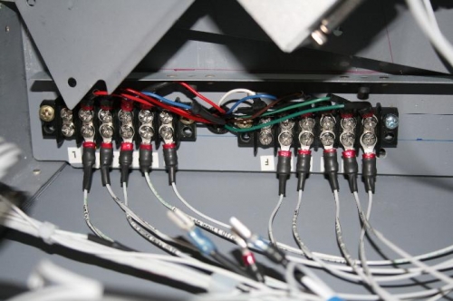

-Connected all of the outgoing wires from the infinity grip terminals.

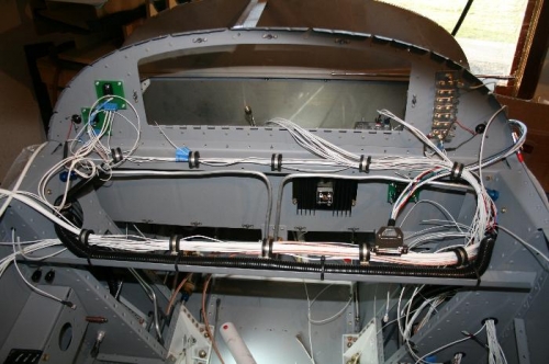

-Installed adel clamps as mentioned previously for the two main cross-cockpit wiring runs. Spent the rest of the time organizing the speghetti into something that looks reasonably airworthy. I still don't have the primary EFIS or the the harnesses for the radios, but that shouldn't be a big deal to add on now that the basic DC power distribution system is in place. The stick, intercom, flood/interior lights, and Dynon are all wired up for the most part.
Infinity grip terminal strips
The two main cross-cockpit bundles are visible in this shot

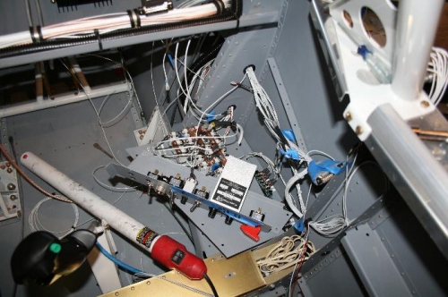

c/b panel
c/b panel
