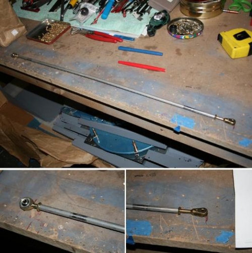

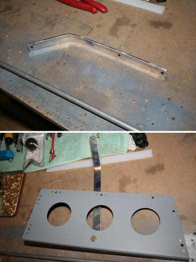

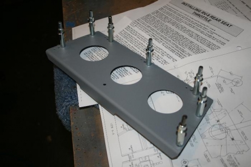

Riveted nutplates (7) onto the rear throtte quadrant bracket. Used NAS1097 rivets. I also deburred the throttle lever and bent it per the plans. Then I temporarily bolted the lever and bracket along with the provided spacers together. Then I fabricated the pushrod that connects the rear throttle to the front throttle. Good progress!
Getting ready to rivet the nutplates.
The lever temporarily bolted to the bracket - rear throttle
Push rod details
Push rod details
