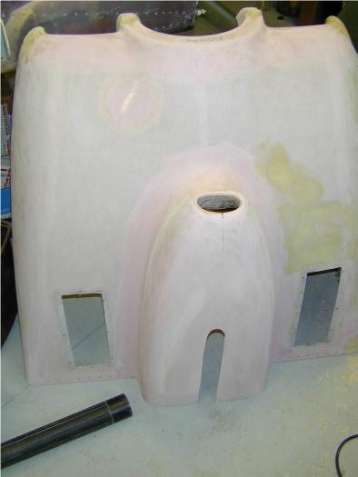

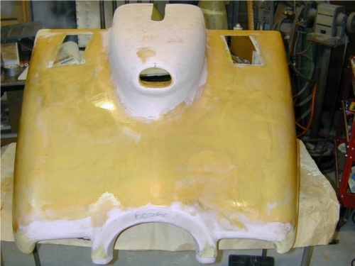

Sanded bottom cowl w/ 80 grit paper to remove all shiny finish left from the mold release. Then spread wet micro-balloons over surfaces to fill pin holes. Once cured in about 2 days, 95% of this will be sanded off.
Bottom cowl after complete sanding with 80 grit
Microballoon slurry applied to fill all pin holes
