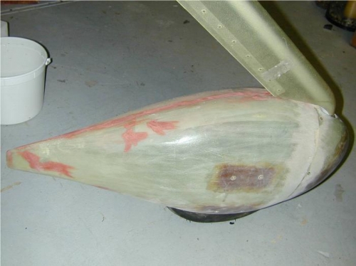

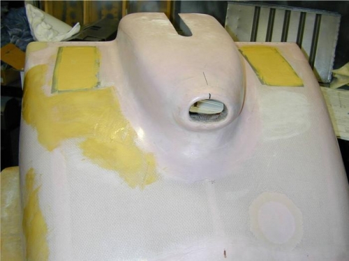

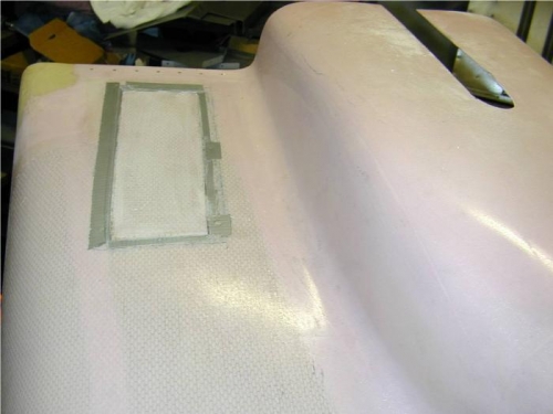

Tapped off cowl ven opening and placed covers. Then microfilled over covers and edges to achieve a perfect edge fit. Also started some trial filling of cowl surface. The painter said DO NOT use auto body laquer putty to fill defects like shown here on the wheel pant. Turns out this stuff is fine for PIN HOLES, but otherwise it tends to not stick over larger areas. So... this will all have to be sanded off and use microballoons instead.
Bottom cowl vent plug edges taped off
Microballoons for fill
Don't use this red laquer putty filler for anything but pin holes
