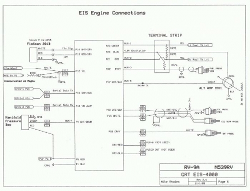

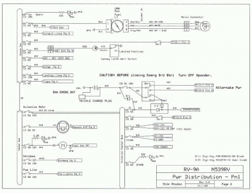

0.50
Updated Pg 2 & 6.
Changed EIS Warning light future function to now be a canopy latch warning. The Red light will be on anytime the MASTER Sw is on and the canopy latch is not fully engaged.
Added canopy latch warning light funtion
Removed EIS Warning light function
