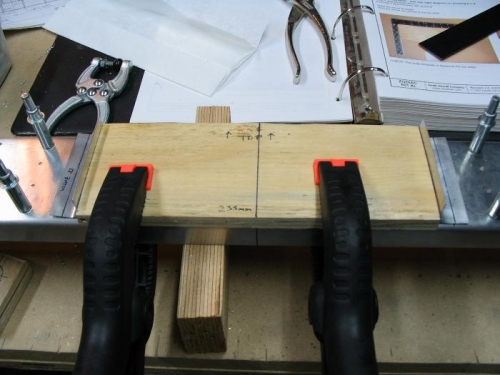

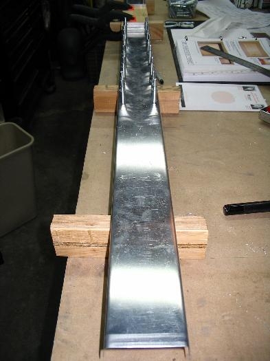

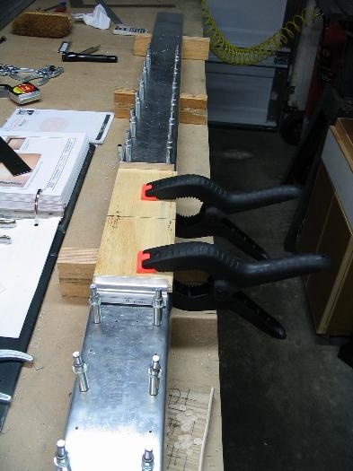

Measured, placed, clamped and drilled the front spar cap doublers. Cut 3/4" plywood to 233mm x 85mm for use as a template in the placement of the front attachment doublers. Marked and drilled the rivet line of the front attachment doublers.
Front spar cap doublers drilled and clecoed in place
Clamped plywood template on front of spar
Template to set position for front attachment doublers
