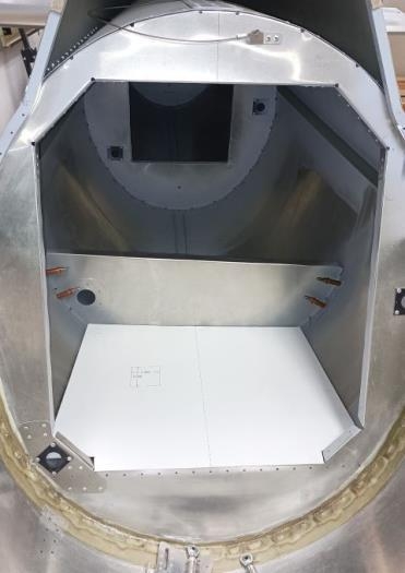

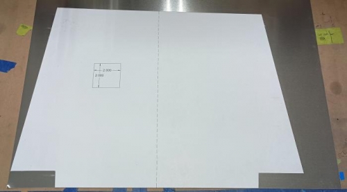

Brief Description:  Final cut the fuselage instrument shelf
Using the "paper doll" design for the rear fuselage instrument shelf, I laid it out with a 2D CAD program, had a full-size print out made, glued it to a piece of 6061 T6 (0.016") and cut out the shelf.

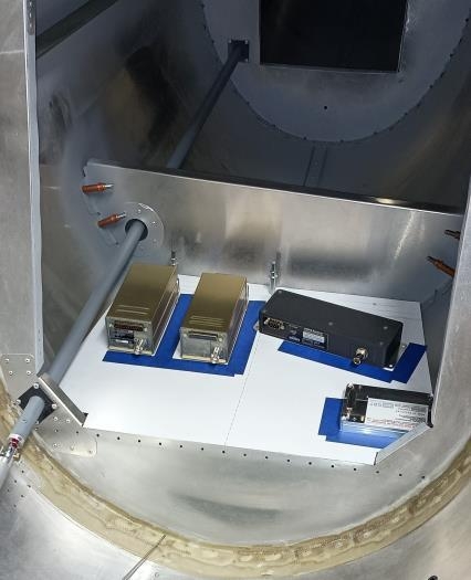

Started to determine placement of the instruments.
I'm going to hold off addressing how and where it will be tied down to the structure until all of the instruments are in hand in hopes that there can be a common approach to mounting them and adding some underlying structure to the shelf.
Glued on the raw aluminum
1st pass locating the instruments
Luckily, it fits fine
