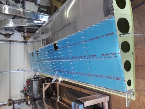

Brief Description:  drill, deburr and dimple right bottom wing skin
I installed the bottom wing skin on the left wing and match drilled. I removed the skin, deburred, dimpled and primed the skin.
After clecoing the right inboard skin into position for riveting, I had my tech counselor over for a visit. The visit went well with the recommendation to remove and test the wing tanks with av gas
Not wanting to deal with possible leaks after the plane is done, I bit the bullet and removed the tanks. 2 gallons of av gas in each and rolling to all positions, NO LEAKS!!!
Ready to put them back on and get on with the installation of the bottom skin…
bottom skin cleco and drill
