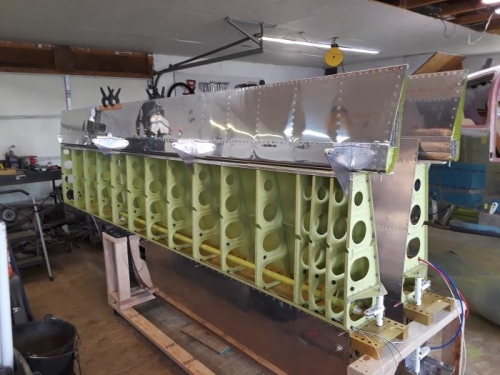

Brief Description:  Install Left tank and rig ailerons
I installed the left tank in order to set the rigging on the ailerons. With the rigging template provided by Vans it and setting the ailerons to the flap position as described in the plans it is easy to set the proper length of each pushrod. I was also able to center the aileron autopilot servo to the centered position. I torqued and torque sealed all of the various bolts and jam nuts.
I will fit up the wing tips next.
Flaps and ailerons and tanks installed
